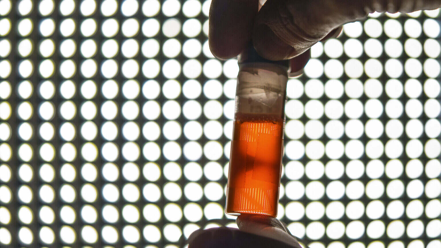

To provide a versatile alternative to the limitations of current approaches, the research team developed two complementary protocols using novel actinometers—physical or chemical systems that can quantify photons. As they are liquid solutions, actinometers can be used in samples of different shapes and sizes. Still, most are not very accurate or compatible with imaging systems and are usually limited to specific wavelengths and light intensities.
To overcome these limitations, the team used fluorescence-based actinometers, which proved to be faster, more sensitive, and able to provide data that is more accessible to imaging systems.
The first protocol uses five molecular actinometers—covering the entire spectrum of ultraviolet and visible light—that emit fluorescent signals when they absorb the excitation light that the researchers want to measure. Under certain conditions, this protocol can also map the spatial distribution of light intensity. The team tested several types of actinometers, from synthetic chemicals for chemists to proteins and photosynthetic organisms for biologists. “We wanted to make fluorescent actinometers accessible to different communities of end users,” the researchers mentioned.
